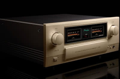

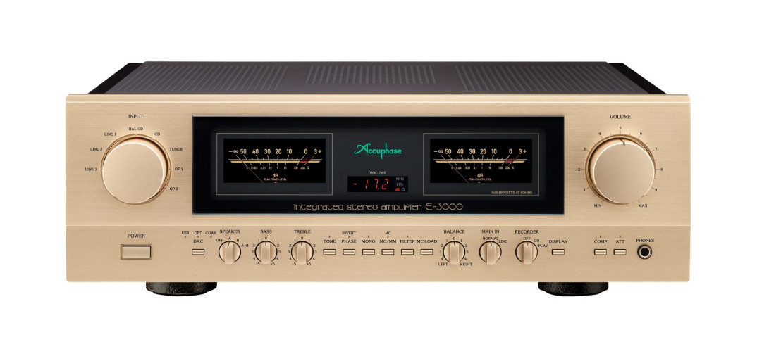

Accuphase E-3000

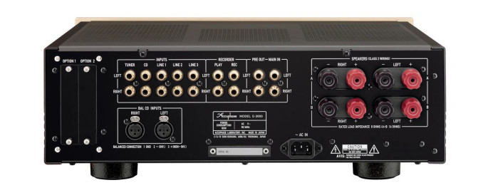

Accuphase E-3000 - tylna ścianka
